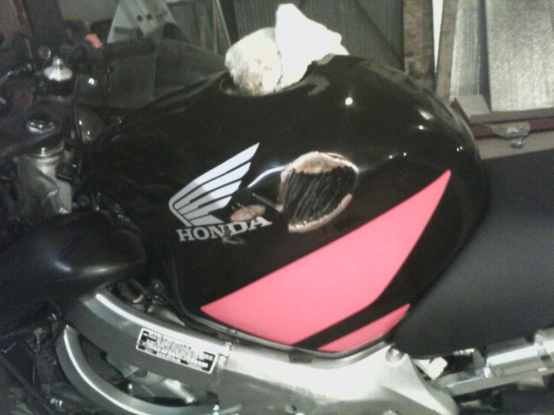

hello friends,
i got motorvated and pulled another bike out from under the tarp. a 2004 cbr 600 f4i with 1500mi on it, wheelied only once:laugh:. i got all the plastic off and it looks like i'll need a few parts. not a bad lookin start though.
i am going to make it a stunt bike and mount it on a trailer/wheelie mechine. like a carnival ride in my back yard. going to mount a cage on it for riding off the trailer too. it just seemed like a neat way to have fun and maybe make some money.
i really know nothing about the whole stunt world :poke: how about yall? got any tips, websites, ideas in general??

That thing will wheelie awesome all day stock. What do really want to do with it? If you wanna parking lot stunt, gearing makes it much easier to go slow, otherwise you're cookin the back brake to try to keep it slow. I don't know exact teeth numbers for the sprockets, but a rear in the 50's is fun for small areas. Goin down in the front you lose alot of torque from small motors like that.
As said, a 12 oclock bar, and the full belly cage. It's gonna get dropped, and a stator/clutch cover or handle bar will end your day. The 12 bar will help you from looping it, but not completely prevent it:laugh: you want one on a stunt bike.
Rear brake modded to handbrake over the clutch is advanced, and kinda cheating. A shorter clutch/brake lever allows you to two finger them and still hang on. Just cut and file the ones on it. It's a stuntbike, it's gonna get abused, don't spend any extra on it!
Also, clip on dirtbike style handlebars are a preference, not a need, learn like it is, keep it cheap!

i already have a list of parts i need to make and buy. 1st thing off im going to go get a book for the thing. think its missing the stator, the flywheel? around it need replaced as it looks bashed up, cover is missing/broken, other than that im guessing it needs some gas and a new battery. i got it given to me by a gal that bought it for her boyfriend. he rode it for a while, then tried his 1st wheelie and flopped it on its side. he broke up with her. she GAVE me the bike. :cheerleader: free stunt bike :cheerleader: i am going to make the cage and 12bar. bought a pipe bender from harbor freight. havent got to play with it yet but it looks like it will work.

Look for a different seat on flea bay, the banana seat isn't always good for stunting. I don't recall if it'll take the other sub frame too.
Build a good cage, 12 bar, rear sub cage with bike pegs, add a t valve and a rear hand brake, build a tail saver( metal plate that goes in the rise between the front seat and pasenger pillion, take the passenger seat cut a hole dead center in it to use as a foot hold.
Leave the front plastics off, just use an off road light or foglight to keep it legal.
Probably lookin at a 60 tooth sprocket.
That';; get you pretty darn far down the stunting road.
