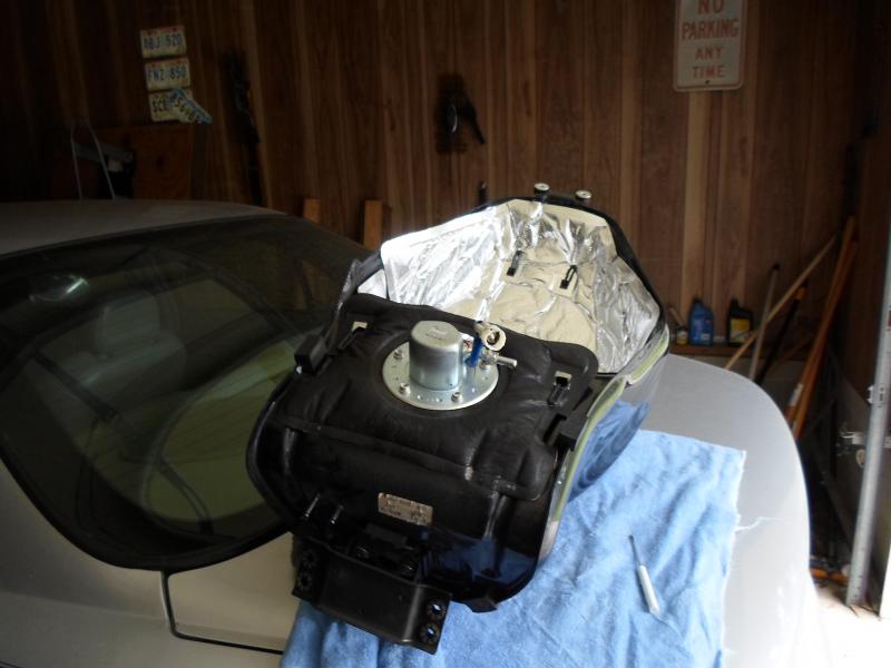

In late April on the way home from the Bash I hit an open straight four lane and pinned the throttle. Went around 11.5K and Hit second gear. The bike stumbled and then took off. I thought , crap I hurt the motor. Somewhere around 50K miles and rode very hard. The bike didn't do this again for about a month and started getting worse. Normal riding was fine. July 4th I took a 1500 mile trip to Florida and on one of our rides I discovered if I pinned the throttle the bike died around 7K and wouldn't run above 130. When I got home I checked with John and he confirmed that it sounded like a fuel pump ( clogging fuel filter ). I learned that if I eased into it I could run on up to redline and 180. I could have found a pump on ebay for $100.00, buy a new one for around $800.00, or buy the filter, bushing, and several o-rings for about $350. I bought a used pump for $350 for my own reasons.

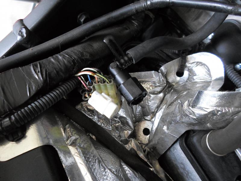

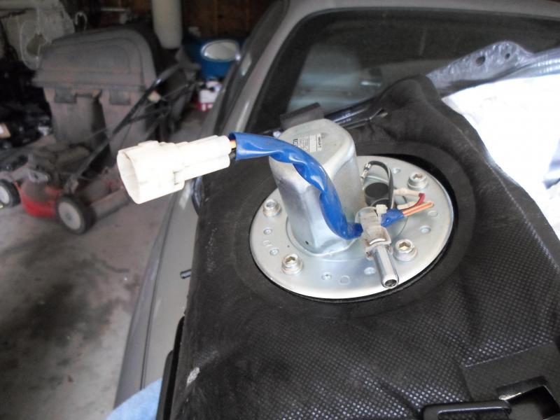

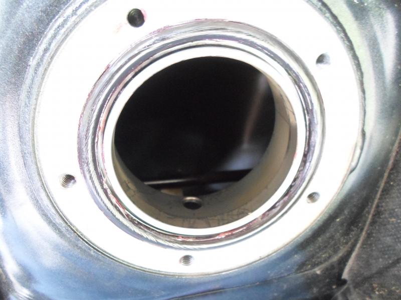

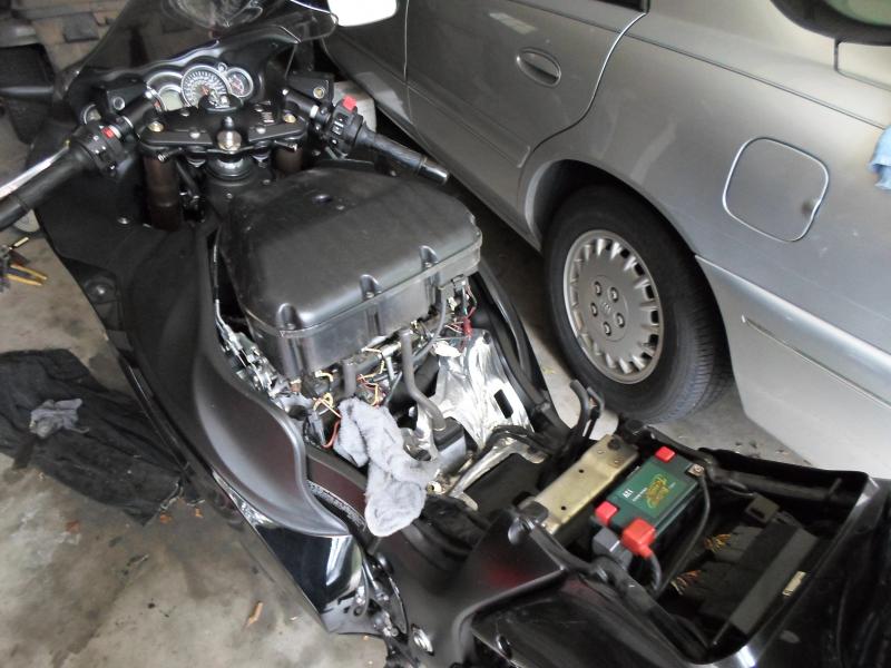

Pump came in and I installed it Friday. Pretty easy job. Running like a champ again right now. Hopefully I'll get plenty of miles on this one. The instructions for rebuilding the pump and for replacing it are in the free downloadable service manuals.
