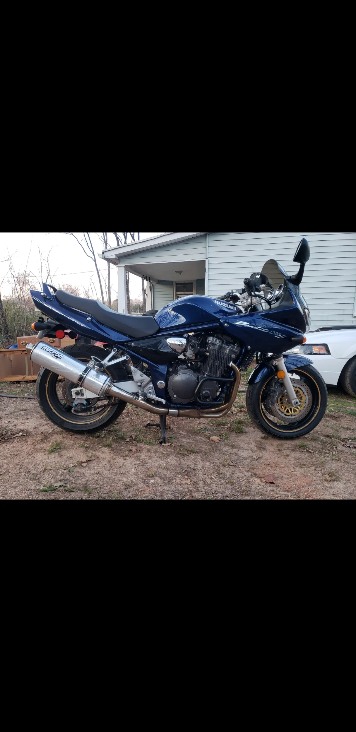

My 1200 Bandit set up like it was would give fits to 600s out on the back roads......they just couldn't believe how fast I could go through the corners on that thing.....those big wide bars sure do help.......that and a decent amount of torque.
Oh yeah, my friend's 1200 Bandit has some serious torque low in the rpms, it hits hard around 3k, and is alot of fun to rip about on.
I talked to him the other day, and he'll be by with a new set of tires for it as soon as I make some more room.
And with warmer weather coming, we'll be doing alot more riding.
He's one to always come and take any one my bikes and leave his, which is always fun for both of us...I might as well own a 1200 Bandit now too, as if I want it I just go get it or he drops it off.
I've been very fortunate to have had a few close friends for many years who ride, as we've always traded bikes about.
It's this one that I posted here a year ago when we went and got it.
These go for $4k-$5k here, and still have quite the following...he paid $2500 or I think even better $2200 for it.
Full exhaust, 20k miles super clean, runs like a top.
