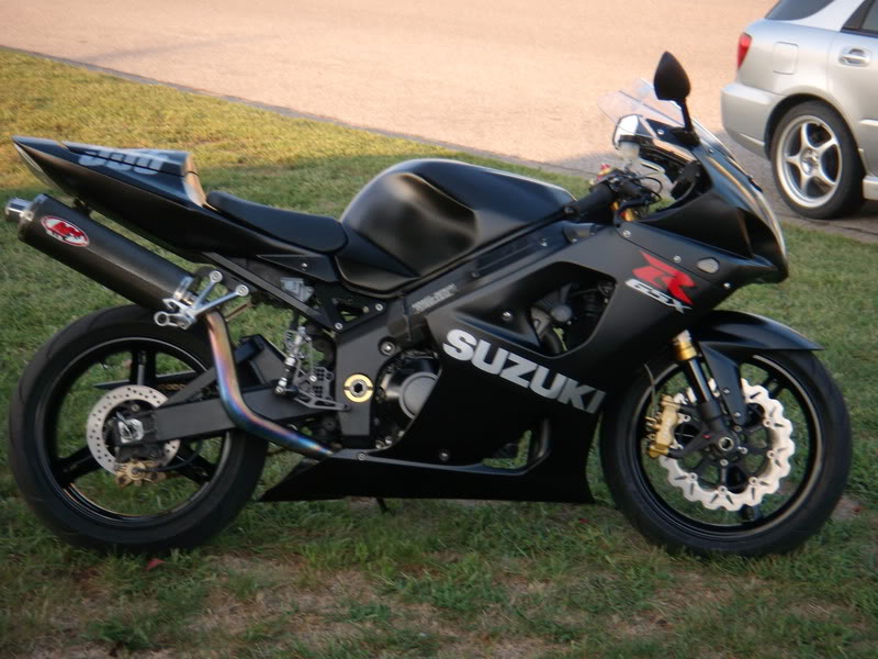

microtel look forward to meeting you. My friend is thinking about skipping out Saturday and doing the Total Control Advanced Riders Course in Maryville. I'll probably go to watch. Here is my bike:
Stock motor,m4 slip-on, 1 up r,1 down f, F&R suspension reworked for my weight, galfer lines pads oversized 330mm rotors, brembo radial M/C, vortex rearsets, woodcraft clip-ons
