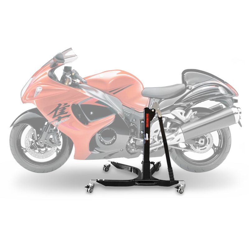

RedBull Registered Nov 26, 2016 #3 Ham said: Just want to know how you guys support your bike if you remove the swing arm. Click to expand...

Big E Donating Member Registered Nov 26, 2016 #4 RedBull said: View attachment 1570036 Click to expand... Can the swing arm be removed with this kind of stand? Does the stand not use the pivot bolt?

Bobby B Registered Nov 28, 2016 #10 RedBull said: View attachment 1570036 Click to expand... If I only had 2,000 dollars to send across the pond to Britain!

sixpack577 Top Gun Donating Member Registered Nov 28, 2016 #11 Big E said: Can the swing arm be removed with this kind of stand? Does the stand not use the pivot bolt? Click to expand... Bursig stand does use that bolt location
