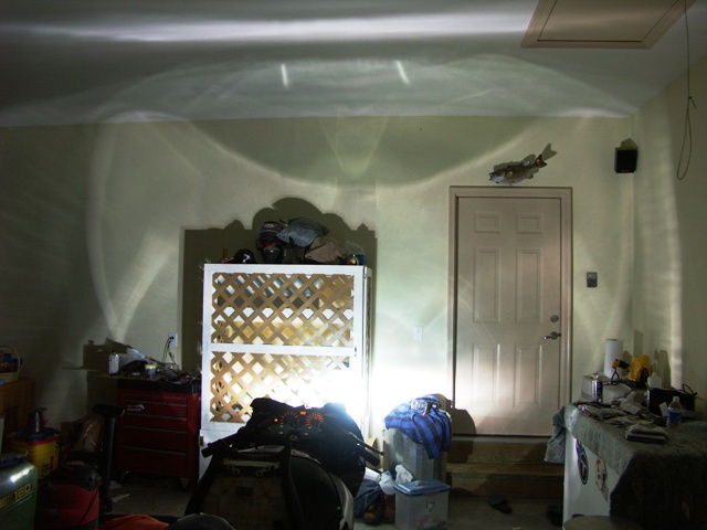

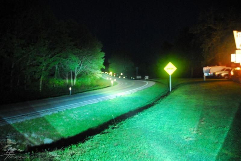

Oh yea the Busa
H7 low beam..
9005 High beam..
1st pic: low beam
2nd pic: high beam
