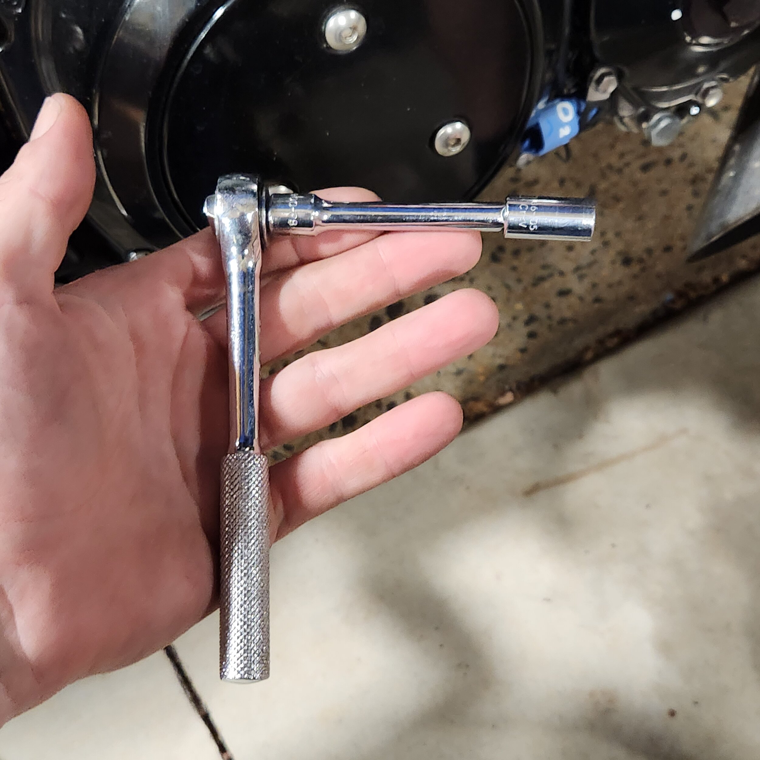

Once that's off, move to the right side of the bike and reach over the top of the frame and under the tank with a 1/4" ratchet, an 8mm socket with 2" extension like this one.
Navigate through the jungle of wires and lines with a handy phone light and you'll see the right side bolt head. Crack the seal and undo it, but not fully! This bolt if dropped will be almost impossible to find/retrieve!!!!
Once the bolt is loosened, remove the ratchet and just turn the extension shaft with your fingers.
So you don't drop the bolt out of the socket and down the engine cavities as you pull the bolt out, first squish some blu tac into the socket to tack onto the bolt head to hold it there like this......you'll never lose the bolt when you pull it out!!

For the right side, grab the blu tac 8mm socket. Squish the bolt head into the socket so it aint going anywhere! Then easily guide the socket extension home into the bolt hole past everything that is in the way. Easy!
