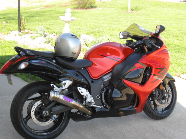

Fit perfect. Amazing how close it fits against the sides of the oil pan. They obviously gave the busa design a lot of thought. No need to reposition the radiator but they did provide a bracket for that. Includes HD heat shields for inside fairings. No damage or melting to fairings caused and I've had it 8 years on the bike. DO replace the oil cooler o-rings as rec by service manual. Minor leak that stopped after a year but I would have rather not deal with the mess in the chin.
A bit heavy but very good quality. 13 lbs, 1.5 oz. Heavier gauge steel and very good welds.
If you get an O2 sensor bung, do it after the pipe is installed unless the person welding is very familiar with this bike. If they put it where they think it should go without seeing it on the bike, no way will you get a Wideband O2 sensor in there. I think I can use mine for a narrow band so it will be my AFR gauge bung but for AutoTune, it is useless in that location.

I am not able to find the page I read this info on but if memory serves, the Cannon made 111 Db and Brocks short meg, A-head, etc, about 108. A couple Db is a very big difference in loudness. The numbers represent exponential increase. If you want loud, this pipe won't disappoint you and it looks great, is unique looking and improves performance, no loss I can feel at low rpm. If you want really loud, you can remove the tube shaped baffle with one screw and according to the tuner I bought from (sadly no longer in business), you can gain a bit more hp with a proper tune.
