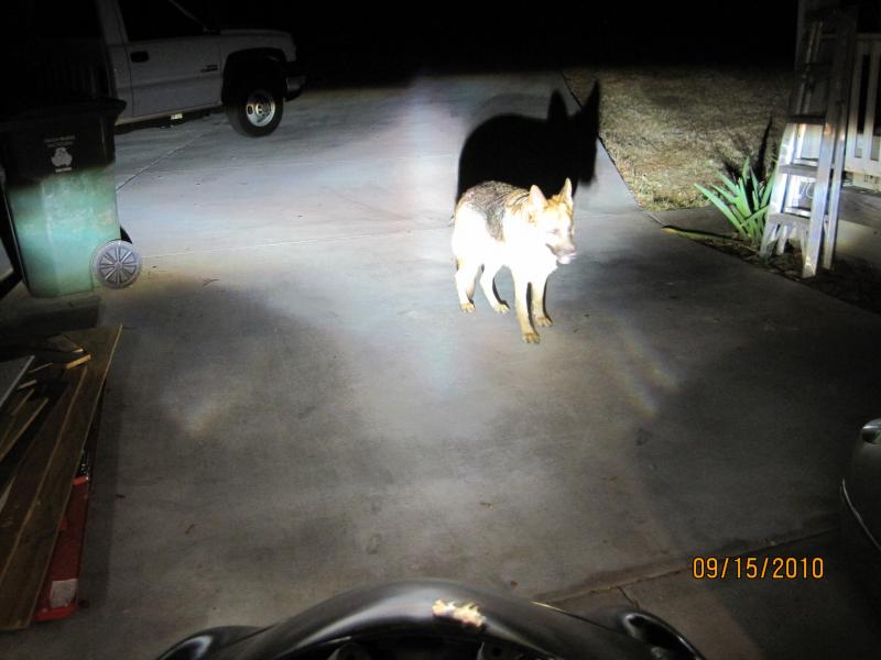

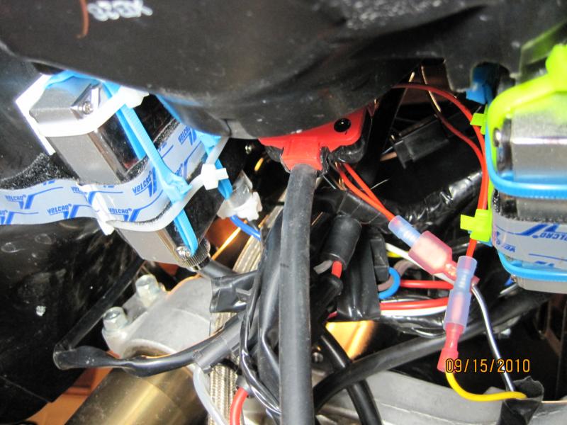

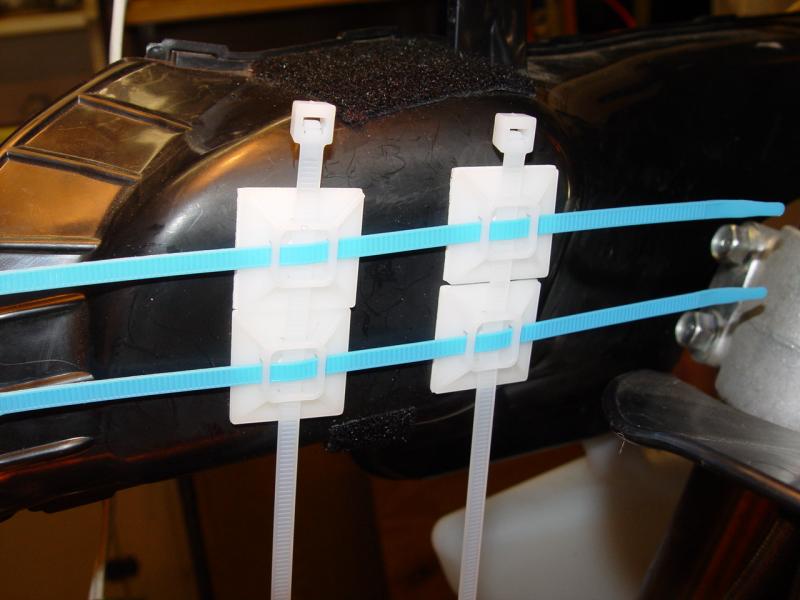

Worked on aligning the lights and finally got it figured out. Not that difficult but hard to get to...check out the pictures. These lights were built by "Ogre", who is now on the east coast in helicopter..."Go, ARMY"...
I don't know of another person who has them on their bike...they are fricking amazing. It was an expensive upgrade but i ride roads at night and live in a rural area so lots of critters on the roads...
Posting a lot of pics so those who are interested in the technicals can get a look at how it is done...Hope u enjoy..by the way almost as bright as a car with high beams on.
If you don't know too much about halogen lighting..both lights are on at all times and when you hit high beam there is shade that flips up and allows the light to go even further down the road...I can see over 150 yds up the road with the highs on...and I will have to measure exactly how far up the road with highs turned off...

These are 55 watt halogens. I had an HID on my high beam...and it didn't even come close to cutting it for night driving in rural areas...my rule of thumb...is you can't drive faster than the light is thrown for stopping distance...if I'm doing 70 mph with the high beams on with the old hid setup...you were really tense because u know the reaction time coupled with the stopping distance versus the lamp projection was not very optimal. And if you had to dim your high beam due to oncoming it was like running out of burning building into the night...blind...totally totally blind...I don't have that problem any longer.
With the 2 halogens with these huge ballasts and igniters...it is warp years ahead of HID. By far the best thing I ever did on the bike for my personal safety...Ogre can be contacted by sending him a personal message on the .org. He created this design for the Busa...look at this way...I spent 3500 dollars for a pair of wheels...1500 dollars for a titanium muffler...all performance products...why wouldn't I spend some money so I don't get creamed by a buck or pig at night? I can see 100-150 yds down the road with just the low beams on...which means both lights are on (top and bottom at all times) and when I hit the high beams the lamp shade swivels up and I can see close 2 two hundred yards out...I would estimate my light difference at over 200 percent better than just a stock low beam and a HID high beam...and that set up was probably 2-3 hundred percent better than stock...

55w double bixenon retro, using sealed gen IV ballasts with integrated igniters. I will still build them, but I can't start any new retros for a couple months. I think he meant that the projector setup is better than an hid bulb in a halogen housing. Build pix are in a thread called "double bixenon retro"

You know the busa comes with some pretty nice lights stock once you adjust them up some, especially the pathetically low factory adjusted low beam. Once I turned mine up my night lighting became awesome...with my high beam on (and adjusted) I can very comfortably run any speed I want as long as the road allows :thumbsup: And no I'm not blinding oncoming traffic, I was very careful to set them just below that level for maximum view. I never get flashed, but my riding buds have asked if I have hids :laugh: All it took was an hour and a half or so of adjusting and testing with the wife coming at me in the car to dial them in and it made a world of difference. For free :beerchug:
2Wheels...try that in my neck of the woods with black pigs that weigh 3oo+ lbs. and skittish deer...not to mention racoons, possum, rabbit, coyotes...no street lighting. and 70 mphs...if you like yours...try mine..u'll feel like Hefner just gave u a week pass at the Playboy mansion...:laugh:
