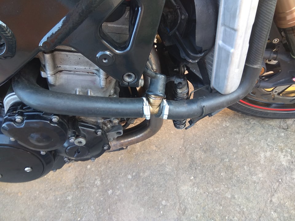

I made myself a temp switch relocation kit.

I made myself a temp switch relocation kit.View attachment 1624007
