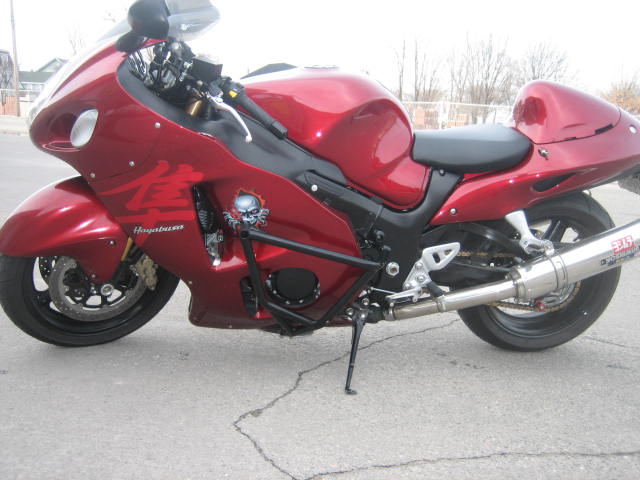

i loved this cage when i had it on had this cage on. its for sale. $250 and its yours. not sure about shipping to england but we can figure it out. shoot me a PM if interested. here some pics. i layed it down to "test" it out.
lol @ you tipping your bike over just to show how well your sliders work. that cage looks pretty sweet, i'm not gonna lie.
It's looks cool. I wish I can find something similar for Gen 3
