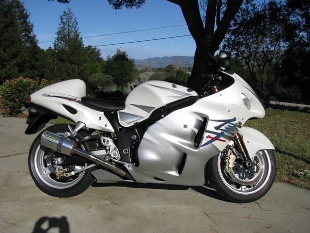

The first one is my 03 FZ1 in Monument Valley on a ride from California to Austin. The second and third are my 06 Busa. The forth is me last month at Laguna Seca on a borrowed KTM RC8R (so you can see what an old geezer I am). The fifth is my 08 Super Duke on the runway at Crows Landing dreaming of LSR runs!
Very nice! Love the photos.:thumbsup:
