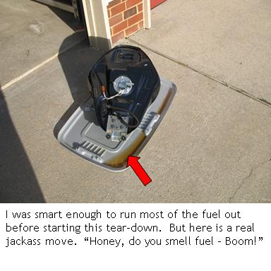

I know I know...Heres a pic of me for you ....
You could pull the fuel line, run 12v to the pump and run a hose from the pump to a gas can (not in that order of course :laugh: ). That's how we do it when we pull fuel tanks at work.
