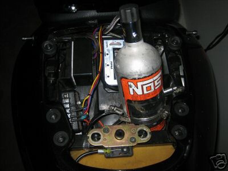

i put zex busa kit on my 06 busa used a zex rpm switch to activate at 6,500 rpms i set it to shut off spray
at 10,000 i use a techlusion box to add fuel from 6k and up --box is tied into arming switch which is hidden in the hole in the tail section easely reached while riding bike ---has stock exhaust w/ bottle in hump works great
tech box and mps fast fuel same thing both add fuel but does not take away fuel if u have a after market exhaust go w/power commander
another place to consider putting the arming switch....your hands never have to leave the bars,just make a simple L shaped bracket and bolt it to the clutch lever bolt
works great

sweet setup bro,mines on the right side dashboard
(gjitsu @ Jan. 10 2007,14:11) i put zex busa kit on my 06 busa used a  zex rpm switch  to activate at 6,500 rpms i set it to shut off spray
Tech box and fast fi box ARE the same box but they are only alike until you hit the nitrous button then that's where the tech. box falls short..Don't misinform folks playing with nitrous...this is how many have gotten melted over the years
