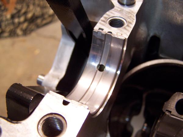

If your '06 does get a knock, you'll know without a doubt. It's a very low, deep,knock and your bearings will look like this if you catch it soon enough. I read that same thread-on here,and just started listening to the bike each time I was warming it up. I must also add this right after a full season ('07)of every Wed.,& Fri. nite and every other Saturday race,late March thu Oct., making at least 7-10 passes each time I went. The only part to fail was the stock clutch. Use good oil and change it every 2500 miles and the filter every other time. The abuse these motors take is a engineering feat in it self.:thumbsup:
