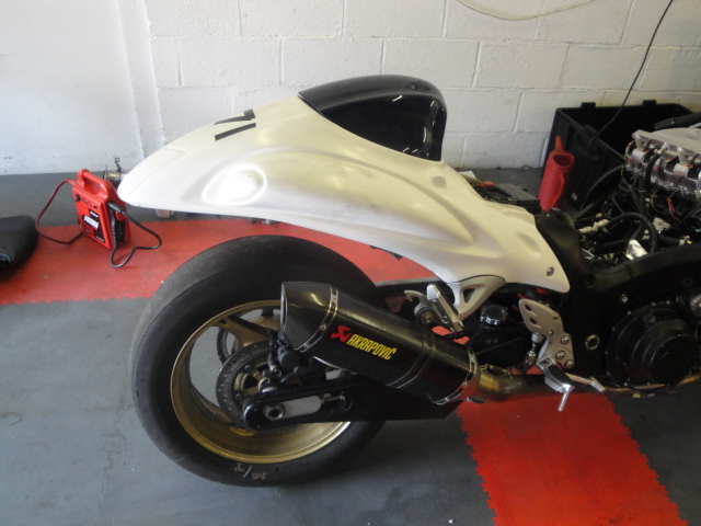

Just a few pics as promised. As you can see its a work in progress. I need to get the rear painted.

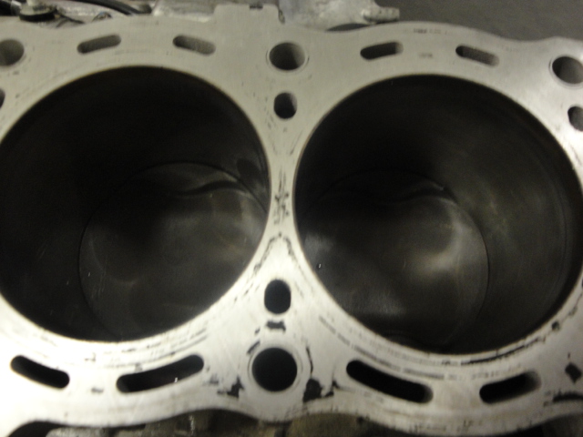

I pulled the top end down and its like new inside, no signs of detonation. I've just rebuilt the engine today with a 52 thou spacer and Cometic head gasket. torqued up the head a little more and put some special gasket sealer I always uyse on the head gasket to help keep it together. I should get it in the chassis tomorrow night. The fit the big blower and see what happens.
