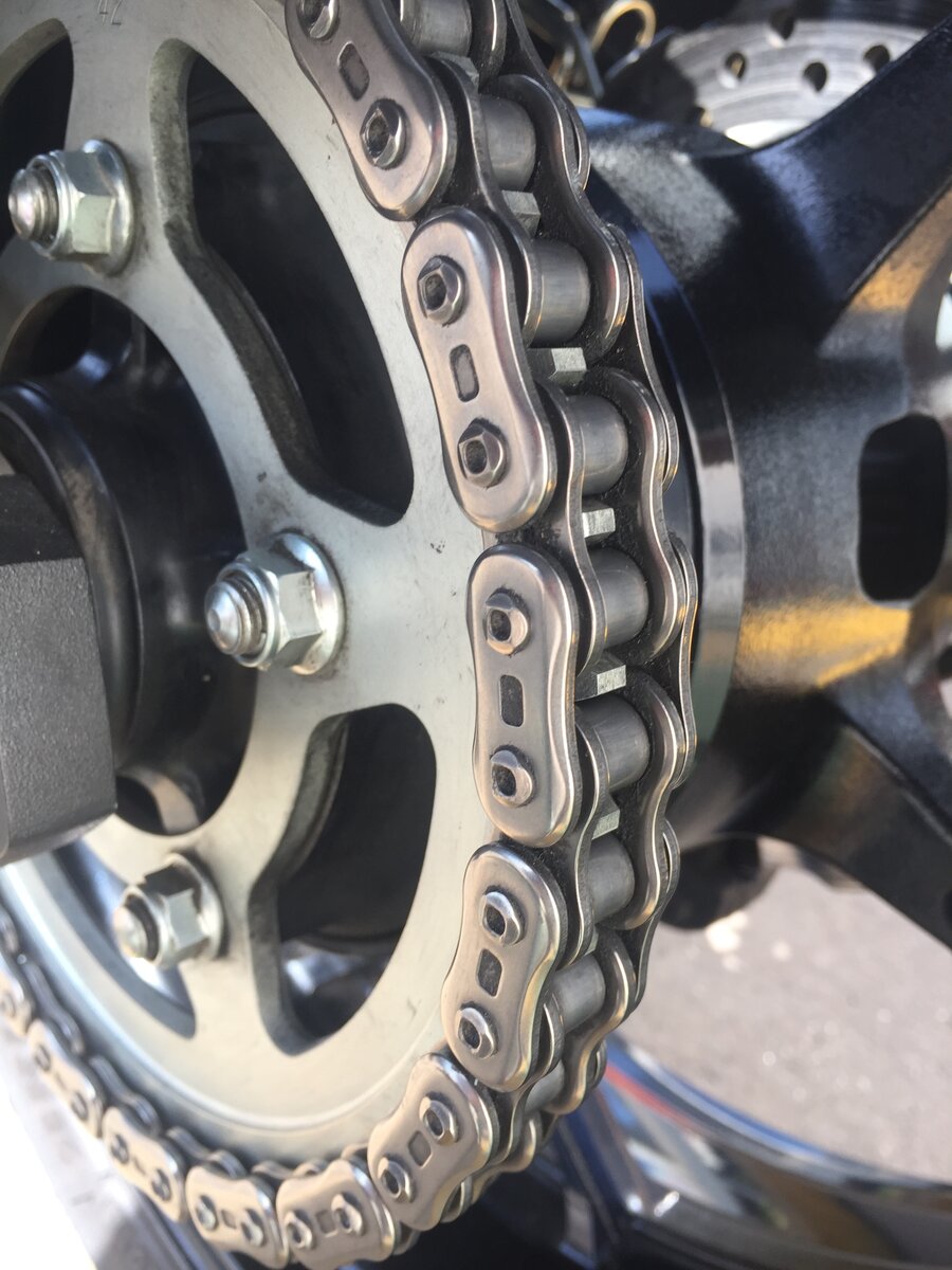

I agree with rubb I am also sick of cleaning the oil off the rear rim and rear fender I started experimenting using this but because of the lock down I cant test the results properly after 200km it defiantly does not fling off but i have the feeling the chain might require more frequent lubing if it last 300km per lube it might be OK some pics attached :thumbsup:
