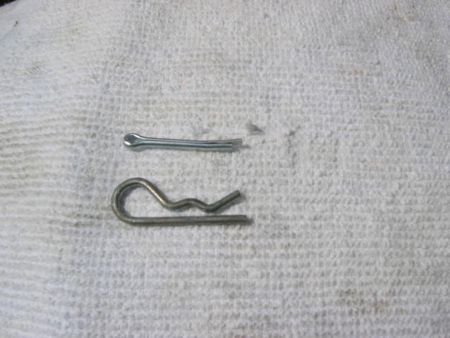

Once you've done it a couple of times it takes all of about three minutes to adjust. The chain can be adjusted while on the kickstand, you don't need a lift. The first thing I do on every new bike is to throw that pain in the ass cotter pin away and use a safety clip. A safety clip looks like a big safety pin. It makes life so much easier. It takes about two seconds to unsnap it and slip it out.

Please replace the Cotter Pin after each use...it may seem redundant but it is the axle nut last defense
or just use a safety pin..
