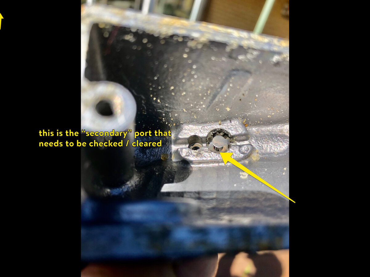

It disengages earlier and earlier until it is instant or not engaging with full pressure causing slipping. I will take the master apart again today and pull the tab back to check the other hole under the metal cover. Hoping to find it crusted closed.

This is a brake master cylinder i had laying about , same principle and design as clutch . the ” tab “ can be bent out of the way to clean / clear the port
ultrasonic is great —— not everyone has access, compressed air is the normal workshop practice , ( not everyone has access as well )
standard working practice would be
1 remove & dismantle. cylinder
2 wash in water , yes. water , brake fluid is water soluble
3 blow off with air , inspect / evaluate. , at this point we are looking closely at this port ( because of this particular problem )
washing the cylinder in alcohol ( mentholated spirits ) and blowing off thoroughly
if you don’t have compression air , leave it in the sun for a while
4 if i am happy with the cylinder ie bore condition, have seen and cleared the port
i usually fit a seal kit , under some circumstance i may just re assemble the unit
i use brake fluid to lube the seals. , ( rubber grease can be used , but i prefer brake fluid )
DO NOT wash / clean with any hydrocarbon ( petrol / gas —— depend on what country you live in as to what you call it ) hydrocarbon react VERY badly with the cylinder seals / cups put a drop of petrol on an old seal and watch it grow
5 i bleed cylinder s like this on the bench as a start point, but doing that after re fitting is fine . As a mechanic. many of the std workshop practices are about time spent on a job. one of the reasons people employ a mechanic is because they should be quicker and more efficient at any given task
this same issue has come up on a number of other forums , with people changing clutches ect . as stated earlier it can often be associated with a bike that has sat / unused for a period of time , or gets very little daily use
that’s my lot
i’ll make no more comment
hope this is of some help
This has to be it. I removed and disassembled the master again. I was afraid to mess with that deflector before thinking it was a valve or something important. But since you said i could bend it I did and that hole was plugged solid. Used torch tip cleaners to clean it out.. put it back together and I could see the difference as soon as I started bleeding it. Thanks again and I will update after a few rides
