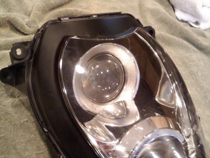

yes, gen 1 has a separate adjustment up and down, left and right, for each lamp, which really helped me line up the two beams. almost done...
lovin it, could you do the gen2 with the bottom being the low beam and the top the high beam even with the single adjustability and can you make the flash to pass work ass well all in a 6k or 6 low and 5k high
dot regs say that the high beam is supposed to be the bottom one if headlights are in a stacked config. otherwise it's the inboard. i can definetly put a bixenon projector where your high beam is tho. stock look, much better performance.

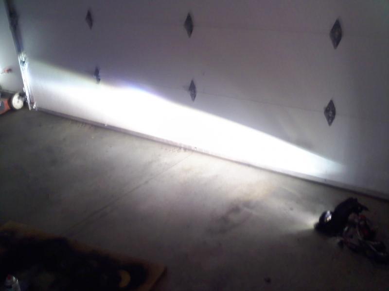

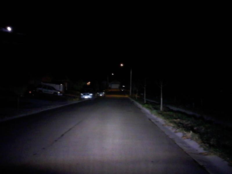

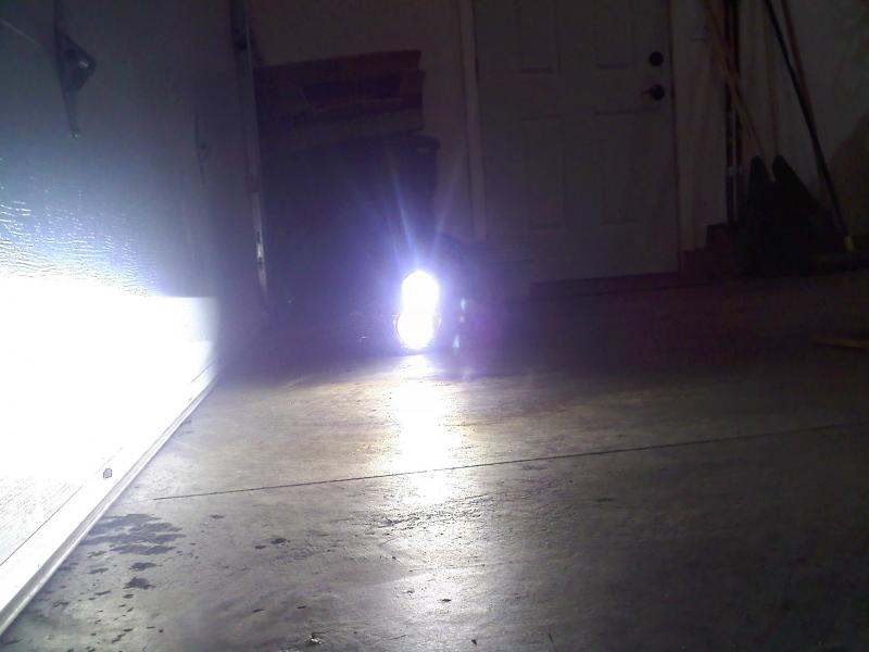

k, it's cold as **** here, so i didn't take many pix. things i've learned from this retro:
not worth the hassle to do a double bixenon retro, it's bling for sure, and it looks totally rad, but the output doesn't benefit as much from the second projector as it did from the first. also, it's hard as hell to mount the upper projector perfectly straight. benefits were realized after the fact, i've got good side illumination on the right, lights up road signs from so far away, it's great. anyway, first shot is dual low beams, second is dual high beams. if you know anyone in kalispell, i'd be glad to roll out for some hi res photos for you guys.
ok, well you can't tell from the pix (yay cell phone), but the high beams illuminated the houses all the way at the end of the block, all the way to the top of the garage. very wide beam pattern, a good 20 feet wider on each side of the road, compared to stock. i want to do a 55w single bixenon next.
