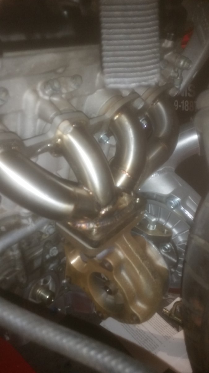

Making this thread for a friend and for people that have been talking about going turbo. My buddy first wanted to go nitrous but after thinking about your only fast when the bottle is full. And since this bike will be doing street stuff a bottle won't last long. So he decided to go turbo and was looking at kits. I strongly recommend rcc kit since a lot of people talk about them. He did find some other kits but I twisted his arm and said you won't regret going with rcc. So a month ago he ordered the kit from rcc and it came about a week after ordered. The kit is very well put together piece and the instructions are pretty good. They were hard for me at times as I am more of a picture person. Lol. But it's pretty straight forward and easy to follow. The workmanship on the kit his pretty high quality. The welds and do fitment of everything is amazing. The hot side on the turbo is ported very heavy and smooth. Some of the stuff is already put together to take installer error out of the picture? The kit took about 2 days to install. Could of done faster if he had all the tools for the install and much better lighting. Lol. Yesterday we finished it up and got it running. Bike sounds amazing and runs great with the base map. Only things we need to do is get a fuel pressure gauge to check the fuel pressure and some vaccum line t's. Then tidy everything up and zip tie all the lines. I will keep this up to date. For tuning we might weld a o2 bung on and put my auto tune on the bike so we can log it. He does want to turn the bike up this summer on c16. The motor is stock minus drop in cams.

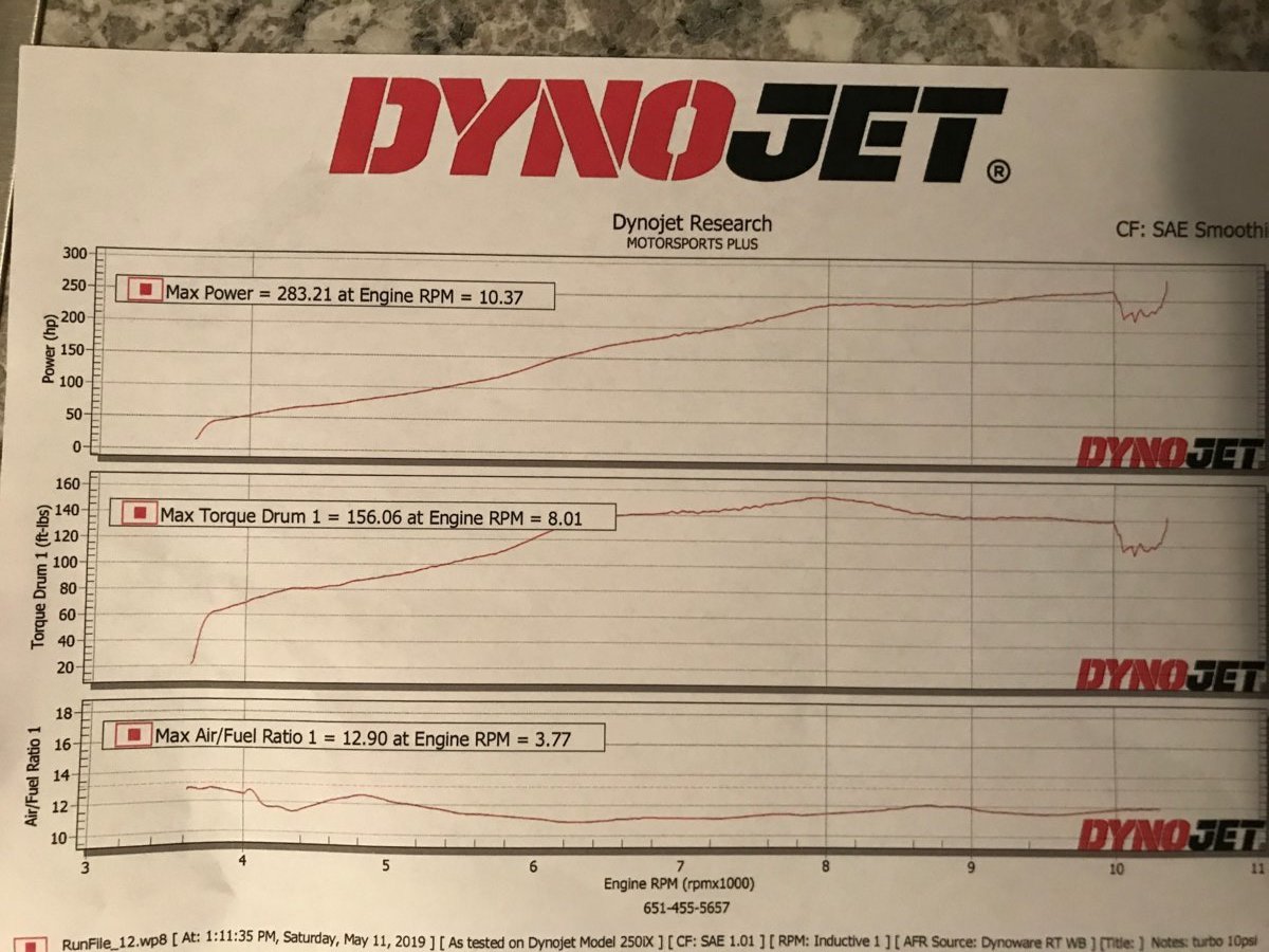

So this bike had the ecu sent out after the dyno tune to get flashed. It was on the dyno yesterday for a quick tune and it made just over 280 after 2 degrees of timing was pulled up top. I will post videos of this bike in action over the summer. He wants to line up against my 1397 busa. I will keep this update and let you know how fast the bike is and how long it lasts at this level.
