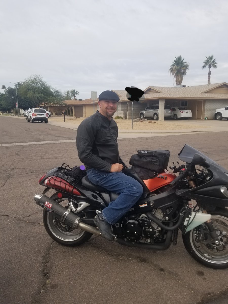

I made my 03 a 2012. Love it to. Still need to get fairings and looking for some chrome rims.
Saw in your videos it has a gen2 speedo. Was that difficult?

No. But I used everything from the Gen 2 but the frame.
