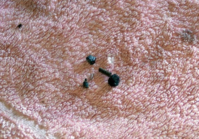

OK call off the posse, I managed to separate the left hand front fairing piece, and it took a fair bit of force to do it. The culprits that were making it so difficult are shown below. some more road gravel, a black plastic rod piece, a small bit of moulded clear plastic and a piece of car windscreen by the looks of it, all tightly wedged in-between the fairing, chin piece and inner panel. I would not be surprised if the right side is the same, but I'll leave that for another day.
Australian country roads strike again, but still better than endless klicks of boring freeways or motorways.
