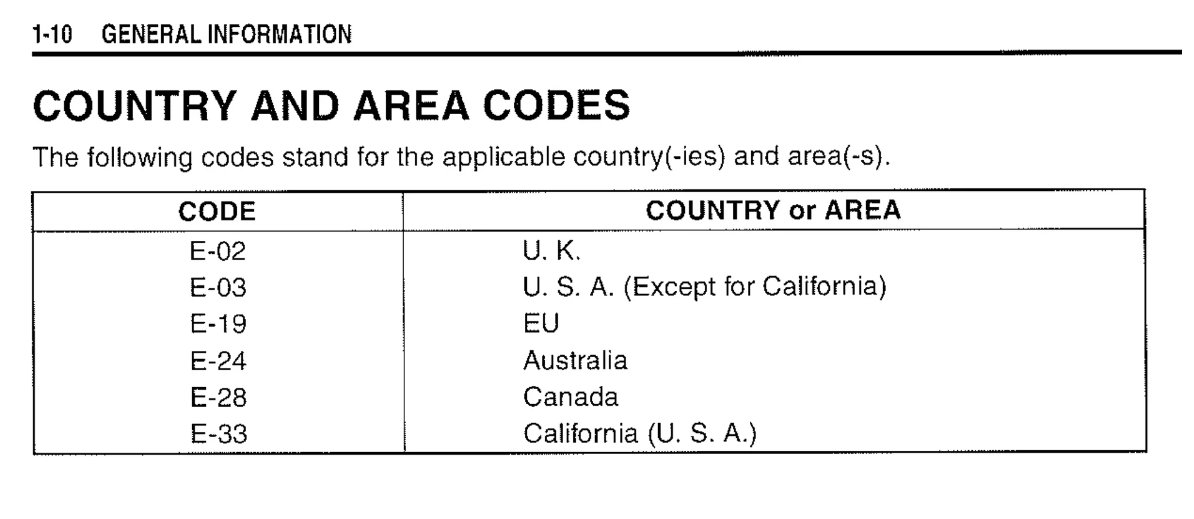

How and what exactly do the letters behind the part numbers apply here?
I assumed it was paint color, but there are 3 different part numbers for the instrument cluster, E03, E33, and E28, and E28 is not available.
The panel behind it is listed as RQ, and RQZ, but these parts are black on all the gen3's.
And All the parts listed are for a 2022, not a 21 or 23.
Country, with California being its own country, for those of you who mistakenly thought it was a "normal state".
It may be in the service manual. I plucked this off of a V-Strom forum:
