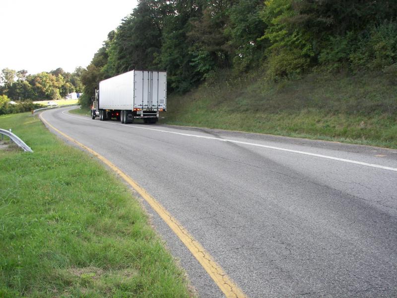

I hit second gear and go into the s turn on ramp pretty good, about 3/4 lean. As soon as I come into the first turn, the rear end kicks out at a large angle, maybe 40 degrees or so. My first thought is...wow, I've felt tires be slick that haven't been scuffed before but man this is feeling pretty slick.
(this is my straight line tire with 3/4 inch chicken strips on it so I've road it on the strip before)
Anyway, I'm like hell yeah I'm hazing the heck out of that tire...watching the smoke roll off in my rear view mirror while it's trailing around the curve. This went on most of the way around the curve (the hell yeah part didn't last but a second or so before it turned into OH :cursin:)
The tire must have been on the outside of the oil strip and burning off at a rate fast enough to keep some grip.
I went to pull the rear end in and straighten it up because the curve is straightening out and there is a rig parked on the side of the road...the tire didn't pull in, not with any grip anyway. I'm looking at the rear of the trailer at this point and thinking well, here we go...it's either hit the rear of the trailer if I try to get straightened out or go on the right side of the trailer past the gravel and into the ditch.
I decided to leave the right side as the main route if needed. The rear end is locked up at this point and still kicked out to the side. I pulled the right shorty lever as hard as I thought it would hold and the front brake stopped me about 5 feet behind the rig.

I lost all the new oil, all over the road and rear end.
Pushed it back down the ramp and towed it home...this actually just happened about two hours ago now.

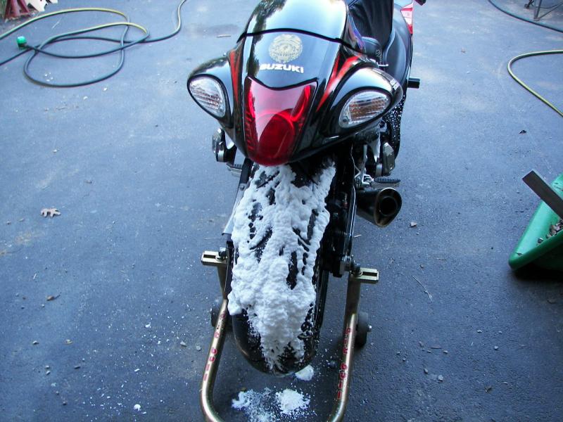

Put it on the stand and sprayed foaming degreaser all over the tire, washed off. Took an electric sander to it. Sprayed again with degreaser and sanded while degreaser is soaking. Did a burnout in the driveway. I think the tire is ok, will take it real easy once the fairing is back on and see how it feels.

+1000, OMG:shocked:::11 'Number 31, now serving number 31,next':grim:and your number must have been 32!!:please: AND the rig with that oil trail leading up to it-I'd still be pulling most of the seat foam out my butt IF, I was that blessed:bowdown:
You keeping those tires? Knarly
Front one still needs to be swapped out for a new one on Monday. Rear is usually only my straight line tire I put back on last night so I don't think it'll be a big deal...haven't decided yet...but it's basically a brand new tire, just used it in a couple straight line runs. still had the nipples on it until I sanded them off after the oil
If it were my normal twistie tire, I wouldn't trust it a bit~!~
I've heard of other tires soaking up oil or anti freeze and still being slick. I figure I was pretty quick about getting this off...still wouldn't trust it in the twisties~!~
I'm going to cruise it up the road at least once before making a final decision, right now I have it cleaned up and looking about like normal. I'm pretty picky though, it'll probably get discarded anyway~!~
