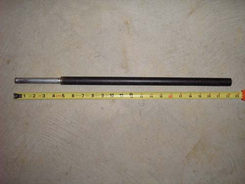

Made this axlerod, also talked about in previous posts. 1/2" NPT pipe and 5/8 solid insert.

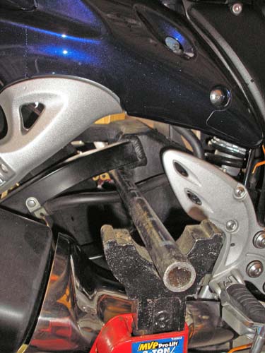

Jack up the rear with the axlerod inserted, then support with upper/inner part of swingarm.

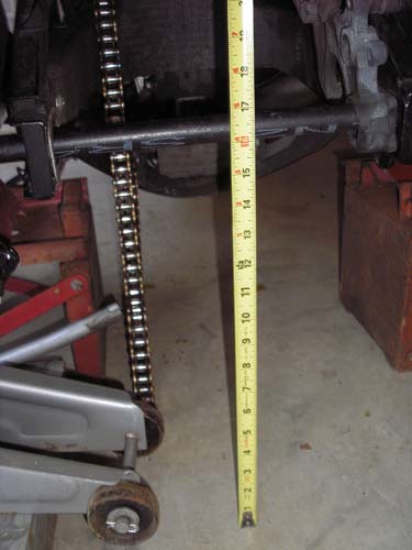

Remove axlerod so you can remove the wheel.
My experience was, the rear brake would love to scratch your rim while you remove the tire
Not sure if you can do this with stands, but having the back end waaaayyyy up in the air helps

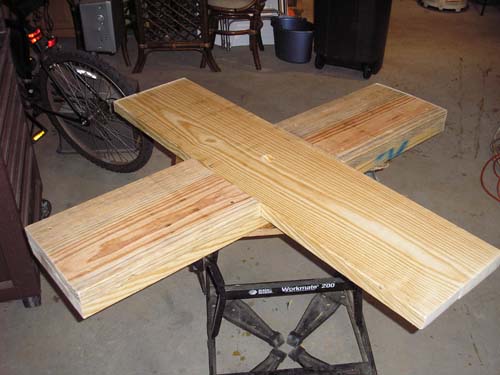

Just a back view, the axlerod gets pulled for use in my homemade tire changing jig
Axle AND homemade Axlerod go through the wood and secure the wheel. Pic is the axlenut and shaft collar holding the axlerod in place.
