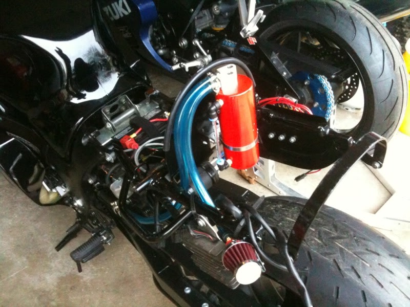

I used the air tank on my arm. I drilled and tapped for -10 fittings on top. One has the hose in from the case and the other has a breather. Then I drilled and tapped for a -6 on the bottom then put an AN cap on that. I'll try and post some pics tomorrow.

It works very well this way i think. I didnt need the air tank anymore and i didnt have to add something else to the bike to do whats its doing now. I was also told it helps with draining being in the swingarm since its lower that the case. Sorry if the pics are blurry.
I have a McIntosh IB pro arm sitting in the garage that has the catch can setup similar to what Ragu585 has. I have a McIntosh IB pro arm on my street turbo busa, but it does not have the breather setup on it. the motor in it now has a stock bottom end that has never ben apart. I have quite a few 14-16 psi passes on it and it has not blown any oil out the breather filter. I have a hays performance flat breather cover on and a 1/2'' line to a k&n breather filter up below the plenum in front of the throttle bodies. My old turbo gsxr 1000 I ran up to 23psi. At first it had a breather right on top of the low profile cover. It would blow a decent amount of oil out it. I put the filter up on the side of the subframe. it would still soak the filter and blow some oil out of it. I then ran the line up between the throttle bodies and put the filter in front of the TB under the plenum. No more oil out the breather. So I just automatically did the same setup to begin with on my turbo busa.
