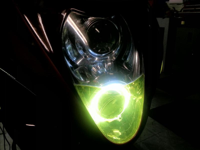

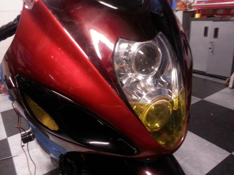

Yes, I was able to get it set correctly, and was very time consuming with quite of bit of material removal from the headligh housing. The halo is held in place using fishing line with holes drilled into the hi beam nose for line to pass through. Some use glue or rtv to hold it in place. I opted for a process that would be serviceable for easy replacement.
My kit required separating the headlight housing to get it to mount. For proper light alignment I kept the housing apart while mounted into the front cowl, making the headlight adjusment (removing material with a dremel). When I satisfied with the headlight level I removed the half headlight to reassemble the front front headlight cover.

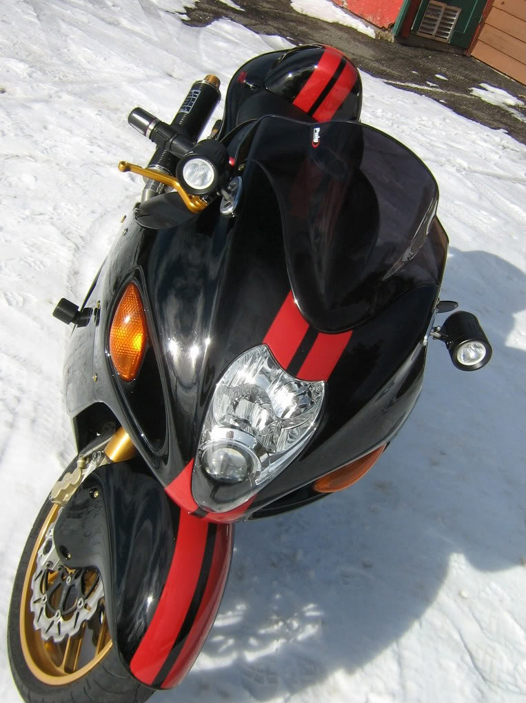

Why bother with just one bulb, when you can replace your mirrors with TWO, count 'em two Trailtech HID spots. Combined with a HID low beam and a PIAA halogen high beam I don't worry about deer, I just set them afire.
:laugh::laugh::laugh:
Cheers
ken
P.S. There's a bar end mirror on the left hand side.
