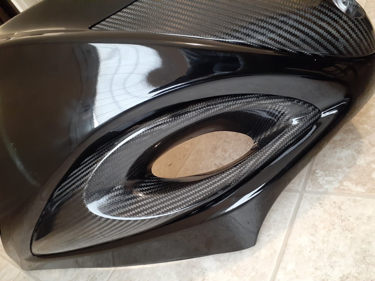

Yep they definitely need a bit of trimming to fit right. I think the quality and fitment is decent compared to most carbon/fiberglass parts I've received in the past for cars. I did use the rubber grommets from the original headlight in between the bolt and the mounting tabs to take up some space.
Update, you'll definitely need a Dremel and a drill. I had to carve out some of the excess material to allow clearance for fitment on the RAM inserts. Just 2 holes drilled and riveted for the headlight.
The end result is not perfect, but not bad imo. I dont regret it at all.
Did you pick up any power with those inserts? I want some except it would be a waste to me if they did not add any airflow. I would be able to see it in Woolich as it would lean out the AFR a little.
