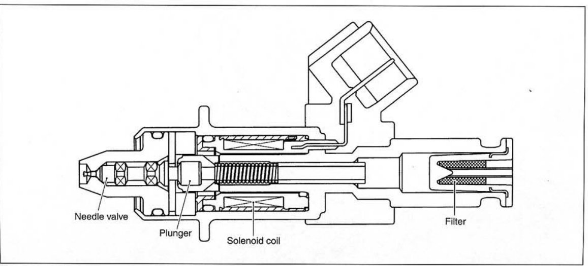

This may sound like a wierd question, but did you add fuel stabilizer to the the tank before you stored it? If not it may have varnished in the injectors a little cutting down on the fuel flow. Try runing some injector cleaner?
Nah no stabiler wuz used . I'll try sum fuel enjector cleaner anyway cant hurt.
I wanna give a SHOUT OUT to all the helpful Playaz that responded to a brau- man in need. Good lQQkn Out
Put a big can of Berryman B-12 injector cleaner in it!
It says that it treats like 20 gallons.
It won't hurt a thing. That shyt works!
Coming from a man with experience like u >>>>>>>>>will do !!!!! Thankz again Pimp (Chris)
If the injectors are clean, it won't do a thing, but if they are dirty, it'll help.
