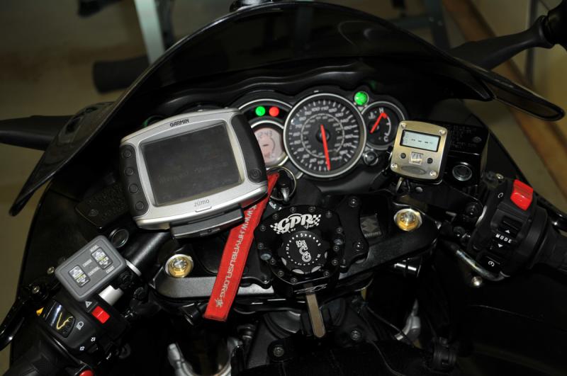

Okay so it came in today and I mounted it up.. Haven't had a chance to run it down the street but it seems pretty straight forward.
Here are some pics....

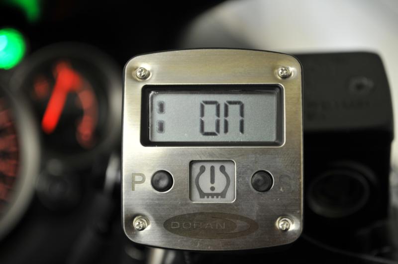

When things are as they should be and your tire pressure is as programmed you get this screen.
If you push the P button on the screen the display will show the actual pressures of the front and back for 3 seconds each for a time period of 30 seconds then goes back to the main screen.
You can see from the left which tire is being reported....
Where I mounted the display... There is a really neat backlight too.... Waterproof and easy to see.... There is a remote alert LED that is very bright that I did not connect. The white area on the front flashes red if there is an alert... so far so good...
