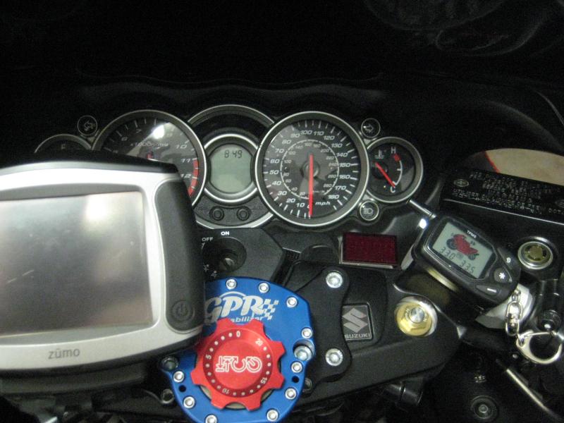

here are a couple pics

Uncle Steve - thanks for pics - how is it attached - velcro, stickum, ziptie, etc - if velcro, did you glue it to the bar?? ordered one based on your comments - should get it by end of next week - your mounting location looks perfect -
Velcro, small piece about an inch by an inch, cut it in half to allow the battery door to be removed.
