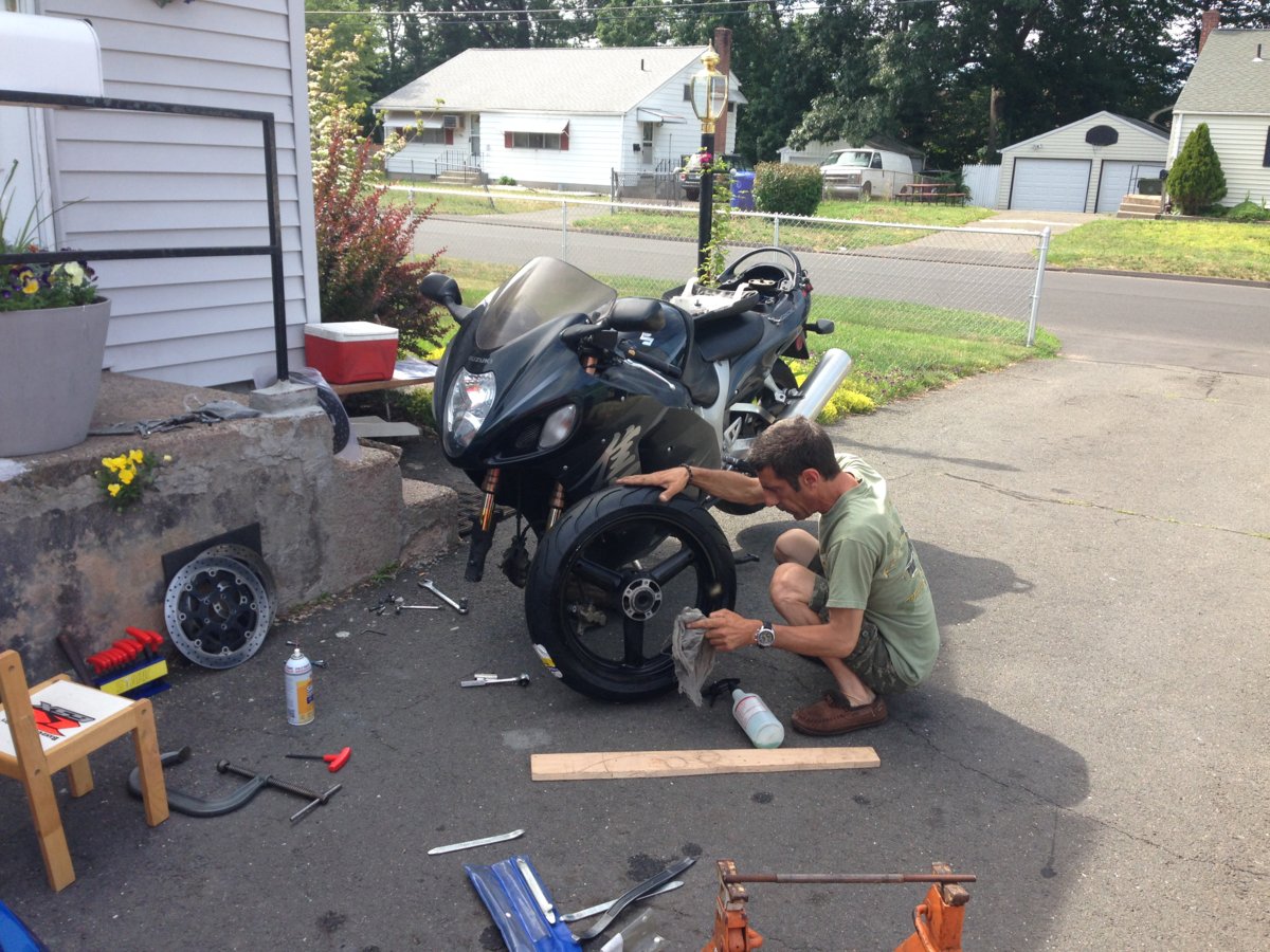

Learn to do your own tire changes , it will save you a fortune in the long run .
