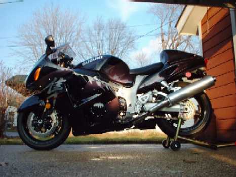

Thanks Dudewizr, you da man. Am I gonna get the good exit flow with my rear wheel up from the stand? Or do I gotta drop the bike level horizonal & then pop it back up again when I put the plug, filter & fairing back on?
