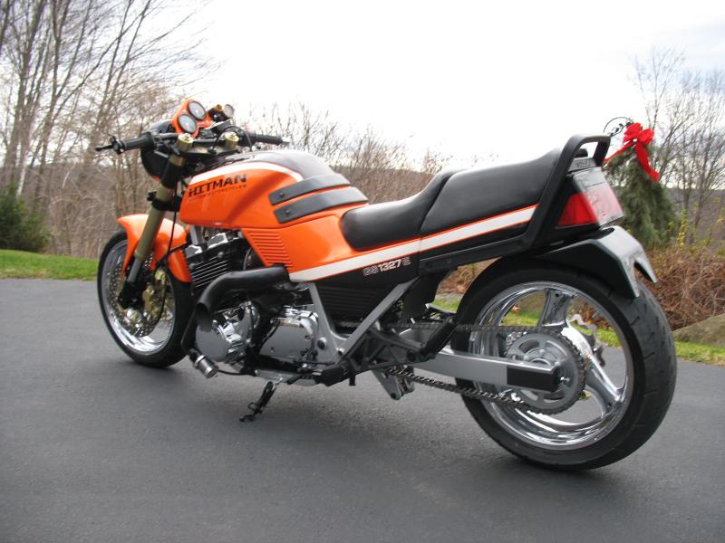

Pic's of my 08 ultra-lite busa

Nice work Hitman! The 1st bike, there is no question you have shaved some serious weight off that baby. And at a healthy expense, no doubt. I know your goal is ultimate weight savings, but my only complaint is the single sided front rotor. With your reduced unsprung weight, I'm sure she still stops quite nicely, however It's not a sacrifice I'd trade for. But that's just IMO.
The 2nd bike is a true one off beauty! Very original & well thought out. :thumbsup:
Keep up the great work. We'd love to see more :beerchug:
My bike stock with aftermarket exhaust weighed right around 545lbs. so you've definitely removed some weight... :thumbsup:
Really nice looking bike nice job.. Very curious about the wieght.
My 08 wieghs in at 510 lbs and the only thing i have replaced is the exaust. Full TiForce dual can titanium. Also when i drag race it i only put 1 gallon of fuel in it.

Thanks for all the interest and great comments, the bike has not visited the scales yet. I will post as soon as I make it to the scales at the dragstrip. My intention was to reduce the static weight by 100 lbs. since the bike stock wet weighs about 585. But, mostly my goal to reduce rotating weight or unsprung weight. This all improves handling, acceleration, and stopping distance. .
well w/ the stretched swingarm you taken away from handling
w/ the 1 rotor you've taken away from braking.
:poke::whistle:
is that lil red bar on the tail section, the rear brake light?
