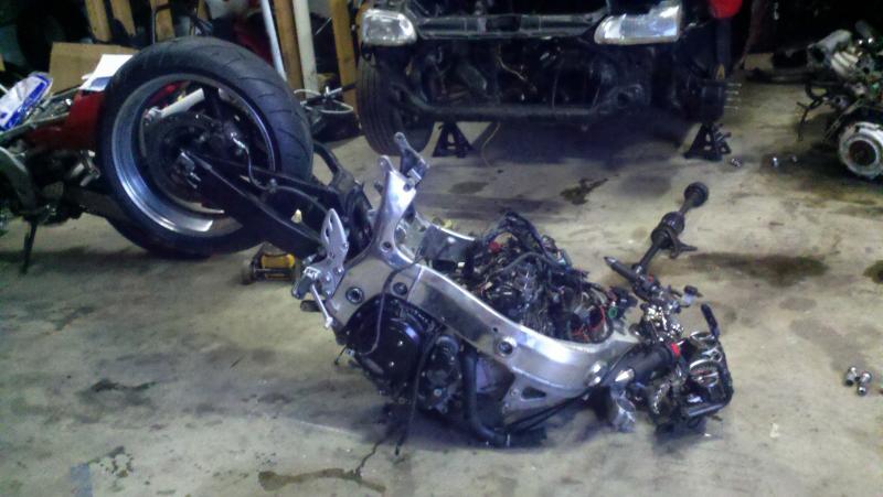

This is going to take me a bit longer then when I first started. I have a lot going on in my life right now. So far I finished with the motor, I chipped/scratched the swingarm so I am getting it re chromed, so for now I put the Gen2 swingarm on until I get the other back. Here are a few pics of the process. Also toke pics of the busa I got the motor from, you can see why I didn't reuse that Gen2 frame.

Lol, well I really don't see a point in a motorcycle lift. It puts the bike in the air but then what? You can't take the motor out or take wheels off. Only my tires touch the floor is doesn't bother me. All that oil is from my brothers car. For the paint I am thinking of either a 2010 Escalade gold pearl white diamond or red from a 08' Toyota Tundra, haven't made up my mind yet. I am going to attempt to put a Gen2 headlight in the Gen1 front fairing. The Gen2 headlight has 6 mounting points where as the Gen1 has 4. Here are the before pictures.

Careful notching that frame. There not very thick to begin with and you'll make a weak point. Looking good tho. Let me know how that Gen2 swap goes. I've had guys tell me it don't fit. Don't know how tru it is, but that was a couple years ago.
I spent a little time today notching the frame for the chain. It was a lot easier then I thought. Installed the swingarm and test fitted the wheel. Changed out the valves and springs in my motor and it's ready to be installed back on the frame. School needs to be over so I can get some free time!
Thanks, yeah I don't think I will get rid of this bike any time soon. Best of both Gens now, can't wait to get the painting started.
