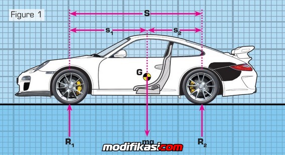

  • Tomorrow we will weight the total weight as well as weight on individual tire.

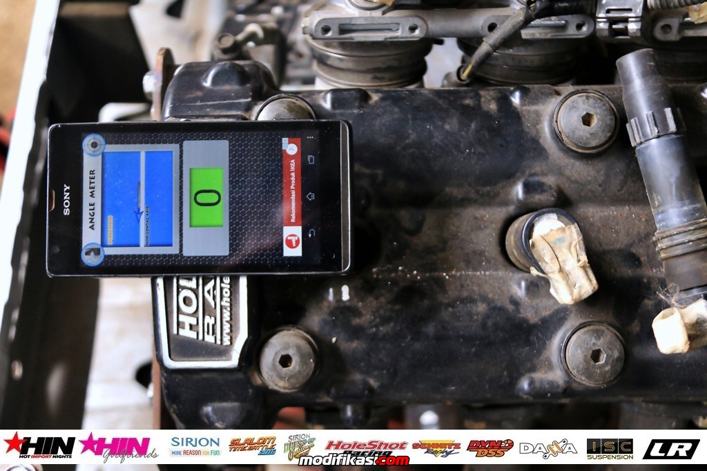

We level the GEN-1 Hayabusa HOLESHOT Engine and take a note on the degree on the head cover

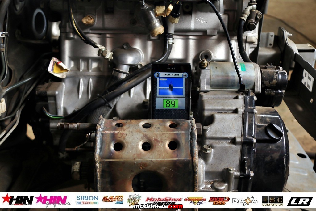

We also make sure that engine sits level vertically (Front to Rear)
We check the long engine mounting bolt on the transmission that it sits vertically between front and rear

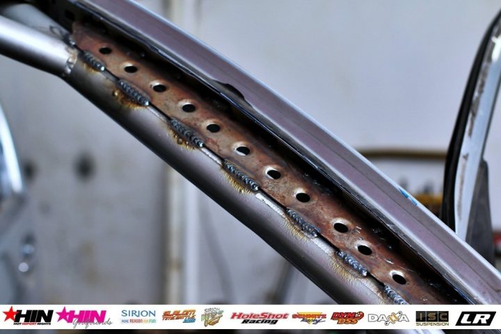

Still working on the ROLL-CAGE.,
Pillar-A and Pillar-B is DONE. Roll Cage has been painted and FINAL WELDED to the chassis.
Front Pillar-A Roll Cage is welded to the car Pillar-A front windshield frame.
Pillar-B Roll Cage is welded to the bottom chassis. Creating additional support for Pillar-B
Tomorrow, we will finalizing the whole roll-cage
* Welding Left / Right side from Roll-Cage Pillar-B to Pillar-C
* Welding Middle X-Crossing Roll-Cage Pillar-B to Pillar-C
* Pillar-C is about where the top rear ISC COILOVER SHOCKS would be
