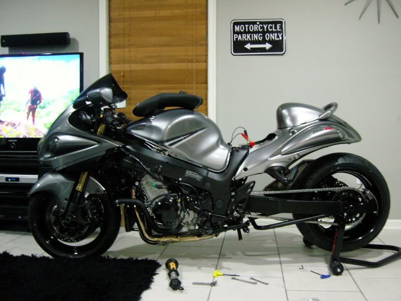

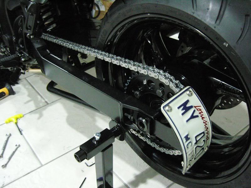

Got my freshly PC'd rim on with new arm and new chain (and sprockets of course). As we all know, that new sticky chain lube that's on the chain when you buy it will fling off and all over everything, especially the wheel.
I'll roll with masking tape on the wheel for 50 miles in hopes it'll get some of the grease. Is there any other ideas on an easy way to reduce it? Remove it like I would old chain wax and re-lube it with chain wax? Any help is appreciated! :)
If you haven't installed the chain then you can go ahead and clean the snot out of it. Ride it for a few min to warm it up and then PJ1 Blue it.
That being said, I would just spray PAM non stick on everything that will be "lubed" by the new grease i.e. wheel, undertail, tailsection. Put it on the rear stand, let the bike run in gear for a while to make sure the chain and grease has "run in" a bit. Then just wipe off some of the excess lube from the chain with a few clean towels prior to riding.
Go ride the bike until the chain gets hot. Then clean the chain well (wd-40, kerosene, chain cleaner, whatever) ride until warm again and re-lube. Then the PAM will let you wipe off the newly aquired "decorations" and clean the bike fairly easily.

Uh why not clean the chain before you put it on ?
Spray the crap out of it with WD40 and then hit it with chain wax or some of the Dupont Teflon they sell at Lowes .
Then put chain on and ride . Why waste time cleaning any more stuff of your wheel ?

Clean it real good w/ Kerosene on a rag (wear rubber gloves) and then lube it w/ either the Dupont or Maxima chain wax. I happen to like the Maxima, but they are both excellent products that produce the same results. :thumbsup:

Sweet, glad I asked. Learned alot of good stuff, thanks for the tips! I'll clean it with WD-40 (don't have kerosene at home to use) and spray some chain wax on it and install. Then whatever happens to come off over the next couple hundred miles I'll pledge it off! This beats the hell out of rolling around with masking tape on the rim!
Get the Dupont chain lube at Lowes - approx 4.00 for an 11 oz. can. Chain and wheels clean up very well with WD-40. Just wipe excess off when your're finished. Dupont "stuff" is called dupont multipurpose dry wax and chaine lube. This does not throw off.
Got it all installed tonight. It's set to roll tomorrow after 5 weeks of building. Thanks for the help!
