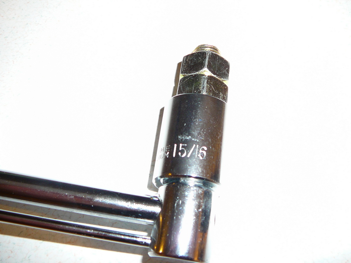

FRONT TIRE REMOVAL (the cheap easy way)
1) 5/8 inch Bolt and nuts and a 5/16th's socket
2) the key is to use two crescent wrenches or open socket with opposing force cinch the nuts together tightly
3) as above us inside nut to loosen putting the bolt in the bike front wheel socket
4) as above to tighten use outside nut and torque to 72 ft/lbs per manual
REAR TIRE REMOVAL
1) a 36mm socket is required if your going to torque to specs (not a 34mm, its too small !!)
the finished nuts and bolt, insert the bolt portion into the front tire socket, use the inside nut to loosen and either end can be inserted on tightening
Once I had all the proper tools etc, it was a piece of cake, Ill never get the shop to pull my wheels again... they charge 30 bucks here in Canada to pull the wheels when tires are changed
