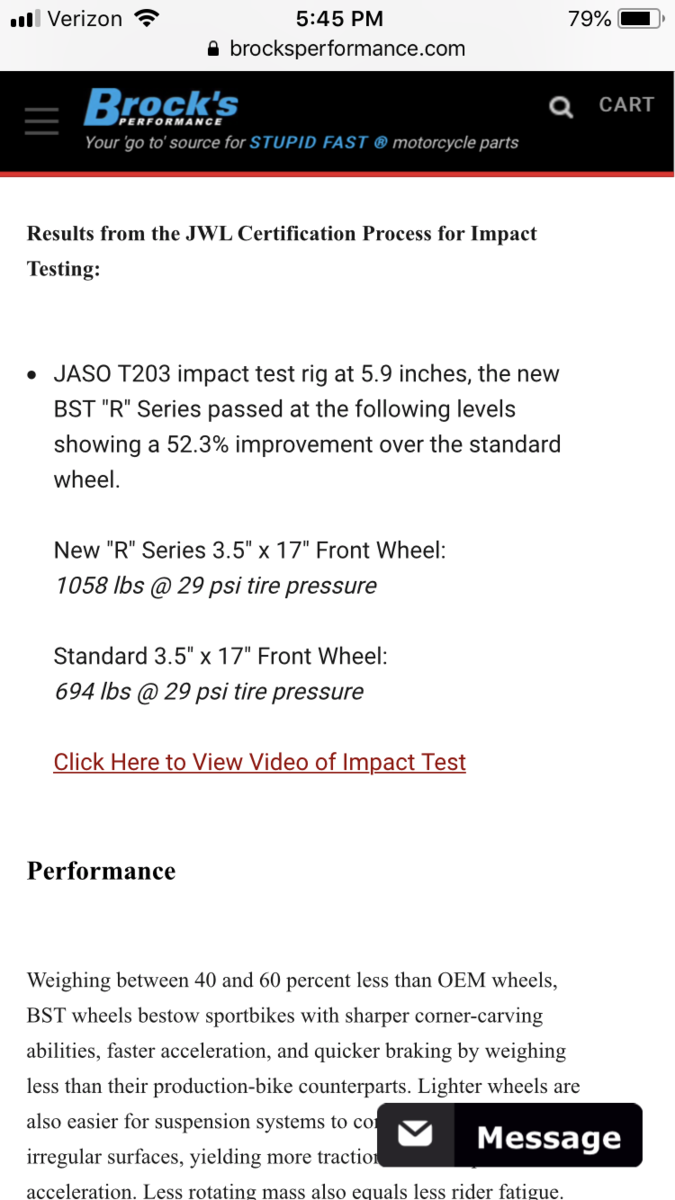

Shite , that was a wild Brocks test !! Hey , have you seen the youtube clip of that crazy bastard ,( not Brocks ) slamming a bare BST wheel into the concrete ground ? A couple of slams and bounces if I remember . I can't find it , but have a look , and check out that horrid abuse if you can .
