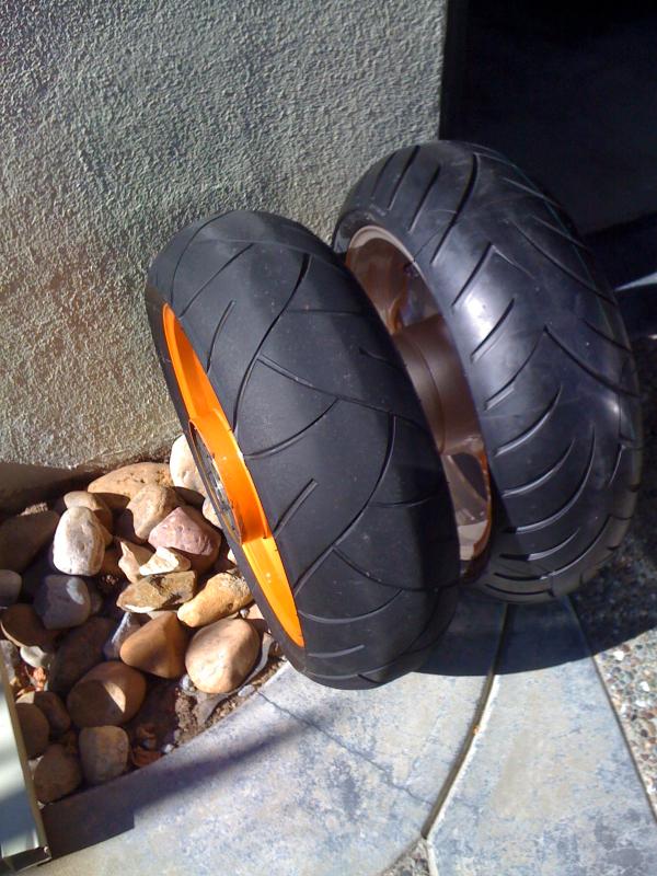

Here are pics of my HPXS i just took off. with 8,121 thousand miles. My opinion the tires are no good the casings are very thin, And light weight. I just put on the Avon Ultra 2s. These seem to be a very good tire, Also i put the 130 on the front. The bike handels and rides so much better. The hps are a dangerous tire my friend.
