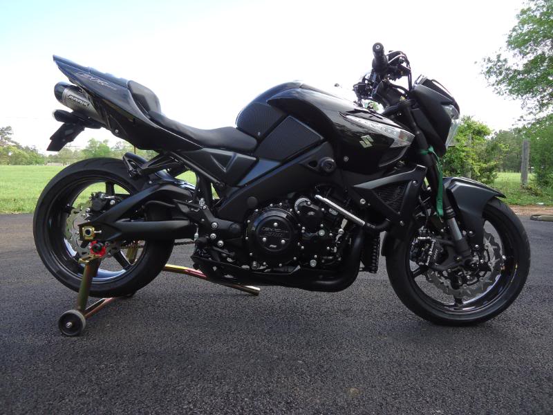

Traded Busa
Did the same trade (except for my Gen1 + cash) back in September. The B-King is seriously underrated and a TON of fun to ride. Congrats! :thumbsup:
That's cool but I call BS on the trunk mod because that looks like it has the room of a 1000 and that's not much at all. I think the blacked out bkings look awesome. It doesn't have functional air ram stock?
No. The side panels on the tank sides are open to the air-inlets through the frame but there is no connecting tube inside. You might get some minor ram-air effect if you ride fast enough but you'd likely get blown off the bike first. :laugh:

That's the plan for mine, blacked out with BST's .
Great looking bike.
