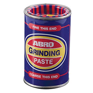

This is my story and I am sticking to it:
Using a wet lubricant on a chain produces the stuff below in no time, as dust is picked up from the wheels, the road and everything that resides on the pavement we ride on.
This pic below is made from exactly the same stuff, lubricant and carborundum (fine soil particles)
I use to be a faithful DuPont dry lube user, until experience taught me a lesson when it comes to chains. It kept my chain shiny and clean, happy customer, but then I found this out....
