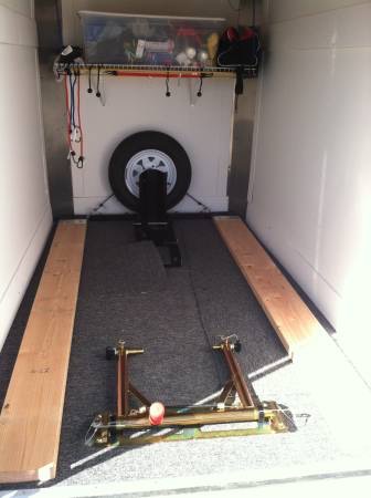

New front/rear Pitbull stands

the 1k mirrors was the last thing i put on after the yoshi r-77's and it make the bike profile look better without the rubber stalk cover of the factory ones. i did take a break from buying stuff for the bike but its still moto related as it will help me move the bike from town to town... got to love the pitbull trailer restraint system
