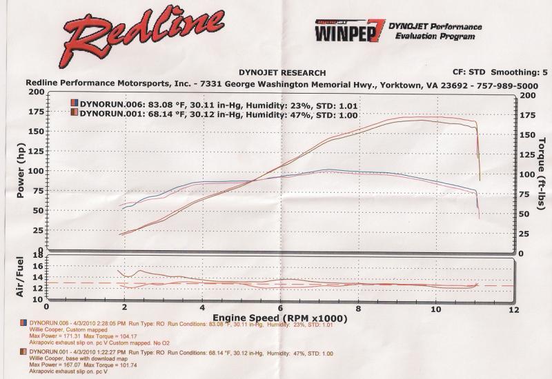

I got mine dyno'd this past weekend and they only got 171 WHP and 104 lb/ft. Bike has PC5, R-77 CF Slipons, stock header with cat, K&N filter. Expected a little better numbers but bike really runs smooth as glass. Throttle feels like it has a direct line to the rear wheel.

Custom map for the win! Nice gains. If you're gonna mod your bike that much, what's a few hundred more to get it dialed right? I bet that $hit flies now!
