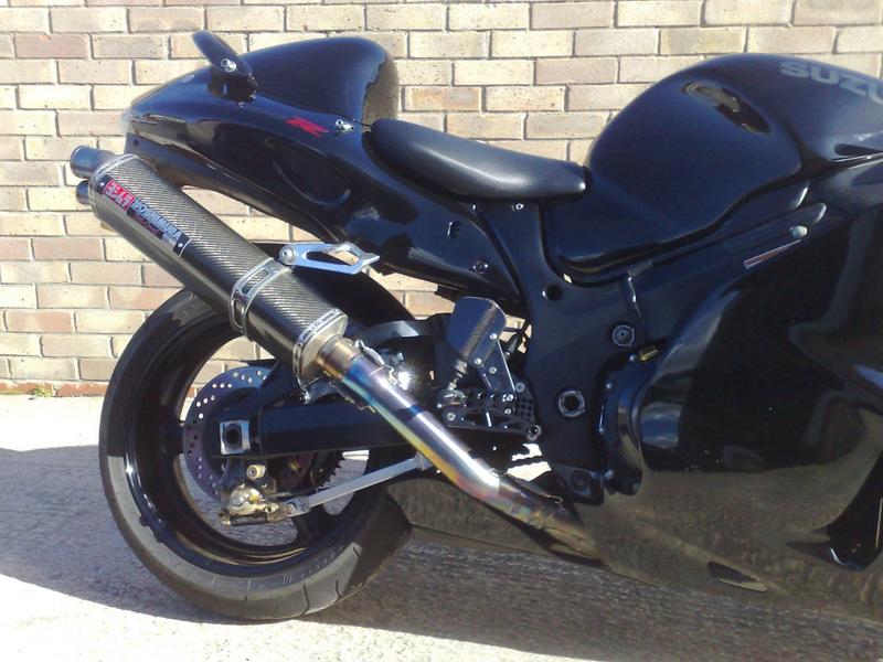

I'm a black K7 busa owner and i would like to setup a new exhaust looking like this:
Of course i found them for the GSXR 1000 on the yoshimura japan shop but a little too expensive :devil:
I'm not looking at a full system, only the two mufflers and the two mid pipes, then i'll work on them to fit on my busa.

Commuta_Busa you think the exhausts on the first pics have been cuted ?

yes, they look like the cans were cut to reduce the overall length. They end just shortly after the pillian mounting points.
Also, the TRI cans could only be purchased in a full race system exhaust as a single can (4-2-1). I'm wondering if the person some how got two end plates with the dual out and riveted them onto a tri oval slip on system. I think this makes the most sense since you would have to take the end plates off to cut the cans.
This means to duplicate this you would probably need to find two carbon slip-on tri-oval cans and then also somehow get two of the TRI end plates. This would probably be the most difficult. Then cut the cans to the length you like. I think it could be done but would involve a bit of home work to find everything.
