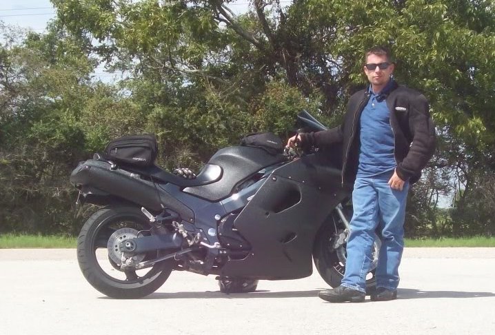

Hi. I had a ZX11 with aSBMike 1300 kit I never had a heat problem even when I went to Fla. for the AMI shoot outs.
I had one two :)
