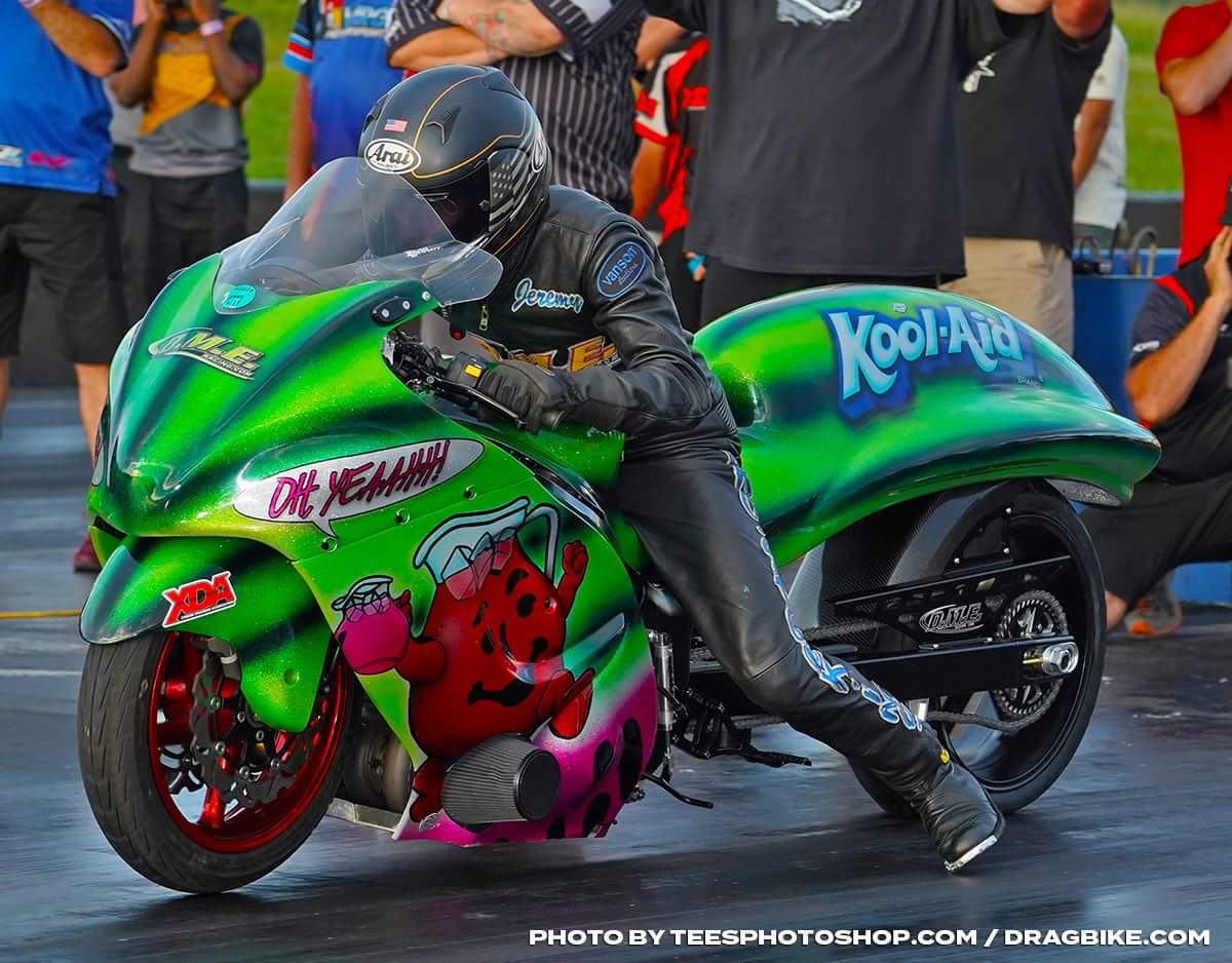

As far as high horsepower and Vortex sprockets. I've seen dozens of 600, 700, 800+ HP bikes go straight down the groove many times. In fact, I've never seen a stupid fast street tire bike with a steel sprocket that I can remember.
630 chain Pro Mods and Top Fuel bikes are a different animal entirely....

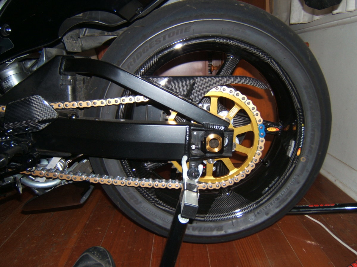

It all boils down to overall maintenance. An aluminum sprocket will last if the chain is maintained properly. Once I do the new chain and sprocket setup, I'll do poly cush drive bushings as well.
Always run an aluminum rear sprocket , that's why I bought BST wheels , to shed weight . As mentioned , a maintained lubed and tentioned chain is fine with Vortex , Afam etc. , and as Dooomz posted , street ridden 190 hp is well within the strength parameters . Also as mentioned , Supersprox is a good choice if you want even better tooth life span . But if like Sixpack , and you are running shorter gearing , and snap it up on a wheelie often , then you maybe want to keep all steel . Ain't many riding hard enough to worry on the street .
