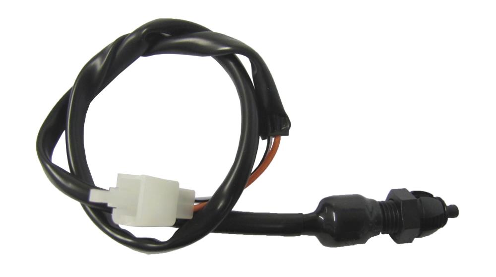

I may be a little confused, but from memory, the wires going to the actual rear brake switch are fixed to the switch. The only connector is at the other end of the wires that plug back into the bike's main loom. THe switch and wires are all one unit - sort of
You are right, II just looked it up and the switch wires are fixed and go to a harness
Where is the other end? Is there a connector into the harness?
Not many pictures of it out there but here's one...
