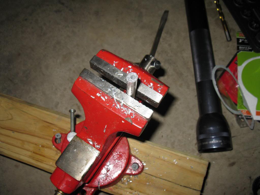

Picked up a 3/8" aluminum rod from Loewes for 5 bucks on my way home from work:
Took me 2 tries to get this right. First try, I cut the rod to length prior to Drilling and Tapping the threads. This was really dumb since aluminum (especially once thinned out from drilling) distorts under the pressure of vice grips, etc.. Prototype 2 started out longer, drilled hole far beyond the length needed and then tapped out, no pressure from vice in business area.
Here is a picture of the finished aluminum insert and bolt from left side. I used this bolt after tapping the insert to hold the shape of the insert during a little grinding to offer some surface area for metal epoxy to adhere to. Not real pretty on the outside, but you will never see it again! :) BTW.. Anyone who says tapping aluminum is easy has never tried it with a 12 dollar hand tapping set from harbor freight. Its very easy to cut out your threads if you do not apply sufficient force throughout each painstaking turn..
